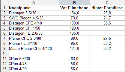

See attached screen shot.
Vor Filmebene = Distance Nodal to film level
Hinter Frontlinse = Distance Front lens to Nodal

Thanks, still need the 60 CF. Anyone got that?
Also, the 40 listed is the 40 CFE. Is it the same as the 40 CF FLE other than the contacts? If there's any change in the lens (optical or barrel cosmetics), the figure listed will be incorrect for my lens.

Yes, but much simpler if I had the exact measurement. All I need is the 60 CF. The 60 CFi version is listed on the Zeiss site @ 32.2mm, but not sure if the CF and CFi versions are the same lens barrels or not.
