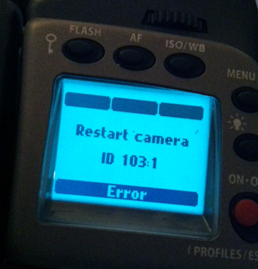

Hello, We've got same error messages generally. Today while we were at shooting, after 10 or 20 shot, camera locked by lens. I looked for every situation for fixing it, but couldn't solve the problem. There was a "No Lens" and "error code 103:1" message on the front LCD. Then we attached another lens, it worked fine! But still don't understand why the lens locked itself while everything is right and clean.. We gave the lens back to dealer today for fix..
Does anybody know what are these codes meaning?

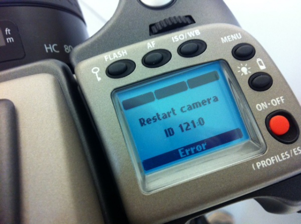

Also sometimes I see "check magazine-restart camera " with an error code message, and I don't know how to restart the camera? The power button doesn't work when that message comes up. We generally replace the battery and camera starts up again.
How can I restart the camera without removing the battery?
Thank you.
