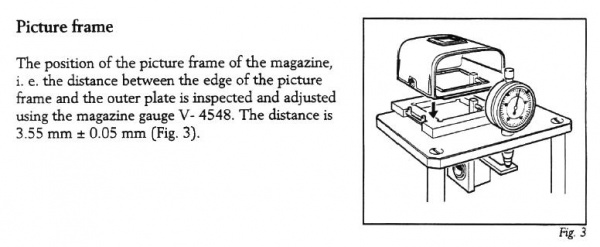

The only part that controls correct film plane is the film frame of the housing.
The insert does not have any influence on this alignment.
It may come as a surprise to you that the insert is not even there when the film frame is adjusted!
Vic.
