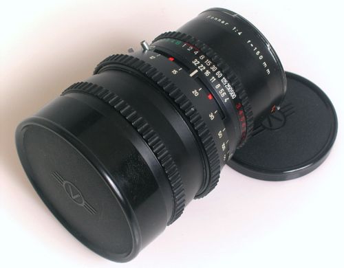

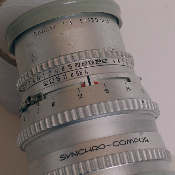

Just got my 150mm CF Sonnar in the mail. I like it much better than the chrome model I almost bought. HOWEVER, there is no M sync lever on it like the one on my chrome 50 Distagon. Does this mean I can only use flashbulbs at 1/30th of a second or slower? I can sync them much faster on the old chrome lenses.

If it is just black you want why not go for this lens:
Zeiss stopped offering a self timer and the possibilty to adapt the flash sync for bulbs with CF lenses.
On some C series lenses the XMV selector was simply blocked by two small screws to avoid accidental shifting from the often preffered "X" position.
