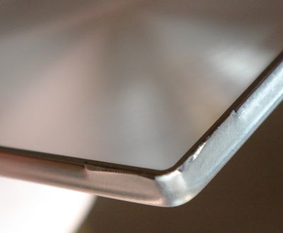

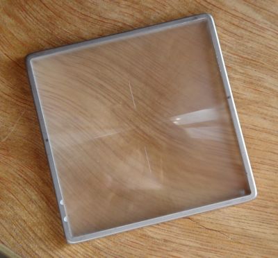

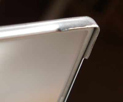

Thanks for your replies. Having looked closely at the screen, there is something odd about the bottom edges of the metal screen frame. They look ever so slightly bent and look like the edges have been filed down slightly - not the quality I would expect from Hasselblad. Maybe I have a non-original screen fitted? It may well explain why it isn't a snug fit. I will try a different screen.
BTW, the screen I have is a plain matte with white crosshairs and two notches on the frame. Looks like an Acute Matte D.

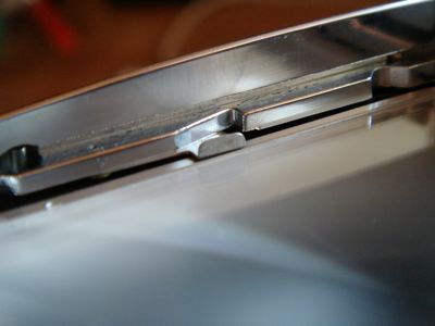

I have added some photos showing the top of the camera, the screen, the rough finish on the corners of the frame, and the clip holding the screen in place.

It apperas your Acute matte Has been "modified" by a prior user.
With care the metal frame can be removed and a standard frame from an older non AM fitted.
That seems the low cost solution for this problem.
Leave the job to a trained Hasselblad technician as this action is not without risk for the AM parts of the screen.
