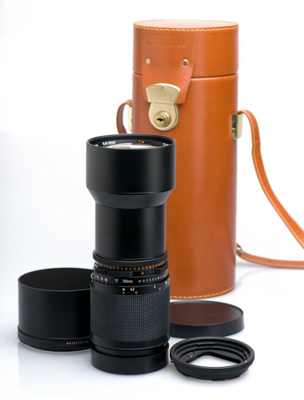

Found one! Today I sent Marc Williams (Fotografz) a payment for his mint 60/3.5 CFi....AND....his mint CF 350/f5.6 lens.
Some of you may remember Marc's post last winter re "out and about" with his CF350. I never forgot that lens.

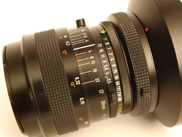

What a beauty! I'm afraid a 30mm CF/CFi is likely to be out of my price range for awhile. Looks like they run between $3,000 and $4,000 USD.
