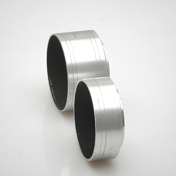

Hello,
I would like to know whether the two Ektar lens, 80mm and 135mm, for the 1600F and 1000F share the same lens hood?
Thanks and Regards,
YW
The hood for the 135 lens is a bit longer.
Other than that these hoods are the same size.
Outside length of the 80 mm hood is 22.5 mm.
The 135 hood is 36 mm.
Please note the 80 hood is also used for the 60 mm Distagon lens.
The 135 hood is also used for the 250/5.6 lens.
Vic.
