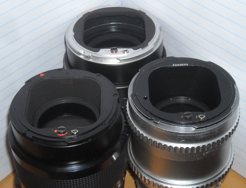

The pin is going into a hole on the C-lenses.
And if the hole is not there, the lens locking mechanism is not going to lock the lens into position.
At the attached picture is three generations of 150mm.
To to the right a C, to the leftt a CF and in the rear a CFi.
Olof, a gold star for you with my thanks!
Yes, that is exactly the camera I have. Your comment pointed me to a conceptual connection concerning the lens-lock button (which I would probably have made eventually - but you saved me a lot of time while waiting for the dastardly old sub-conscious). The connection is this: on my 500C with C lenses, the lens-lock button must be fully depressed to un-mount the lens as would be expected. But for CF lenses, it must be fully depressed to both mount the lens and to un-mount it. When I mount the CF lens while simultaneously fully pressing the lens-lock button, the CF lens slides in and locks like it should. Excellent!!!

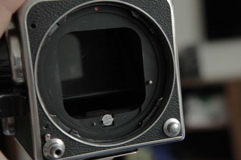

You say that you have a 500C body?
How old is your (camera) body?
In the first (3?) years there was a pin at 3 o'clock, looking at the lens mount from the front. see attached picture.
And the C-lenses have a hole that corresponds to this pin that the CF and later lenses doesn't have.
If this isn't the case, then I don't know. As all lenses should fit every body.
