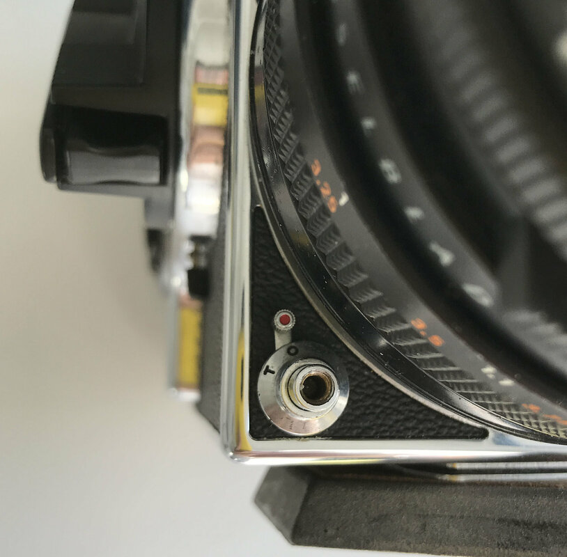

There is a small lever around the shutter button the locks the shutter in the open position.
Press shutter and turn. Mirror will stay up and you can focus!.
Hope it helps.
