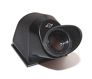

Bought another NC2-100 from KEH, so that gives me two of those to use. Are they difficult to take apart, to remove dust in the interior spaces of the prism??
"Bought another NC2-100 from KEH, so that gives me two of those to use. Are they difficult to take apart, to remove dust in the interior spaces of the prism??"
Difficult is related to the expertise and skill you have, hard to say.
Most NC2s could do with a piant job.
That is a good reason to take the prism apart and clean the glass elements.
These acquired dust and often have a thin layer of particles that reduces clear images.
My expertise is heresay.
I am lucky to have a good technician who does these jobs for me and returns the prisms in as new condition for a modest compensation.

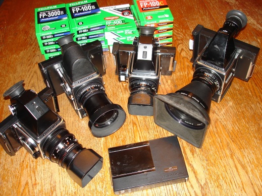

Packages are arriving here for my Instant Film Project. Fifteen packs of film so far, in three speeds. The NPC back I bought which fits tightly(ten I tried did not fit tightly) has a problem with the rollers not properly squeezing and spreading the chemical pods, so it's going back to the local store, maybe they will swap the rollers for me, for a set that does work properly.
400 speed Fuji B&W has been shipped from Unicircuits in Japan. It is only available over there.
I have ended up with three good Model 100 backs, to use on my ELM's, with my NC-2/100 and HC-4 Prism Viewfinders. One back for 100 color, one for 100 B&W, and a third, for 400 B&W or 3000 Speedy. And of course they also work with my 500CMs. But previously, I had no way to do instant photography with a prism on the EL/Ms.
I also now own two good NPC backs, I will use on my 500CM with the old Meter Prism, like when I am working outside. Again, one for color and one for B&W.
These backs were 300+US when I first bought my new 500CM, back in the late seventies. Now I can buy good (properly working) ones for $30-$40 price range. So it makes sense to me to go ahead and have access to all the available instant emulsions, to work in both my 500C/Ms and 500EL/Ms.
It has been a bit of work to pull it all together, but it is well worth it to me. I have always enjoyed running test exposures prior to shooting regular film. With all this new equipment, this is a true luxury for me. And why not, the cost is -very- reasonable!
Here's my Instant Photography System
Three Model 100's, Two NPC's, Four kinds of Instant Film.
I'm set for a while.
