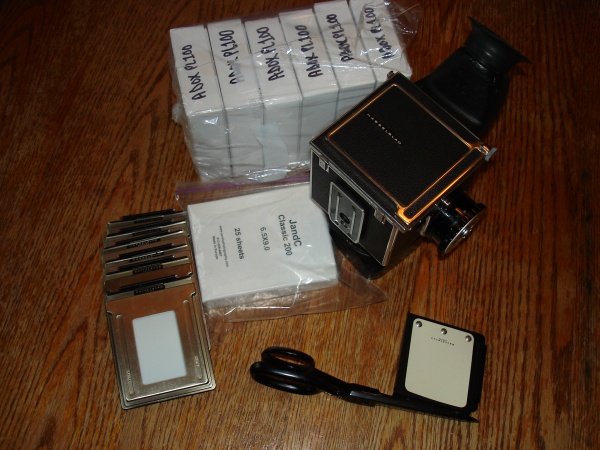

Hello All,
Going through my Hasselblad tubs of misc equipment in my studio, I came across the parts for the Single Exposure Back system. I have the Plate Holder (which fits on the camera body), six film holders, and the special Scissors for cutting the sheet film. I opened all the holders (one had a piece of film in it!) and blew out the dust.
Defrosting an old sheet box of Ilford HP-5 (not HP-5+!), which I will cut up and load into the film holders. I must say the Hasselblad precision on these holders is -amazing-. Also the 500C/M with folding hood, and plate holder, and six plates, takes up very little room! I will also use the knob with the Gossen Meter in it. Beautiful little package, very compact for carrying around with the 80mm T* black Planar.
I enjoy view camera photography, so this will be an interesting experience. I like the slowness of the entire process, to get one -perfect- negative is the goal. I am presently looking for the old Nikor Cut Film Tank, I think this is my best bet, for film processing the 6x6 cut film. Is there a better daylight tank made for 6x6 cut film?
Anybody out there ever use this part of the Hasselblad system? Anybody have any literature on this? Thanks! -Dan

Here are the Parts, Laid-Out for this Project
Hasselblad Single Exposure Back, Six Hasselblad Film Holders, Special Hasselblad Scissors for 6x9 Cutfilm, 300 exposures of ADOX PL100 6x9 Sheet Film, and 25 exposures of J&C Classic 200 6x9 Sheet Film (probably FOMA200?).

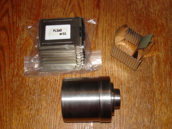

I have picked up a few more #51012 Hasselblad Sheet Film Holders. Nine of them have been now loaded with Efke PL100 B&W film, three more are now on their way to me, for a total of twelve holders. Enough for a decent afternoon's shooting. Also the max capacity of the Nikor tank.
I took one holder out with 500C/M 80mm Planar and Yes, it is quite interesting to restrict oneself to just one frame, to make it the best it can be. I did expose the plate, and had alot of fun in the process. Like a little hand-holdable view camera.
The Nikor Subminiature Cut Film Tank is the answer to hassle-free multiple 6x6 sheet film processing. It holds twelve sheets of 6x9 cut film, or twelve sheets of 6x6 film, cut-down with the Hasselblad Scissors. It's an inversion tank, so should work very well for me. Will let you know.

Now I am Ready to Roll. Hasselblad 6x6 Sheet Film.
OK, now I ready to expose some 6x6 sheet film in my Hasselblad Film Holders. I now have twelve of them, enough to fill my New Nikor Tank, the film is held in place precisely with the "Nikor Subminiature Sheet Film Rack", which holds twelve sheets.
At this point, I have the 12 Hasselblad Sheet Film Holders loaded with EFKE PL100, which I precisely cut down, using the Hasselblad #41092 Film Cutter, in the dark. Freestyle Photo and B&H Photo still sell EFKE PL100 (I have 150 sheets at present) and EFKE PL50 6x9cm sheet film. B&H also sells EFKE PL25 in 6x9, so I think I will buy additional film from B&H. I've used PL100 in 4x5 in the past, I think I will develop the sheets in PMK+ Pyro Developer, that has worked very well for me. All I need now, is some warm, clear weather.
Here is the new Sheet Film Rack, with a piece of 6x6 sheet film, for practice loading. Also the twelve loaded Sheet Film Holders, ready to go:

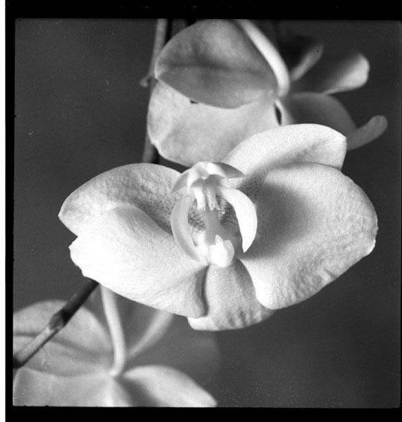

Here is a Test of the Hasselblad Single Exposure Back.
Hasselblad 500C/M, 135mm F5.6 Planar-S on Hasselblad Bellows, Broncolor Hazylight (modeling light only) F22 at 1 minute exposure, Efke 100 6x6 cutfilm, developed in ADOX Borax MQ developer.

I can see that dust, dirt and fingerprints are more of a problem with the extra handling involving sheet film, versus roll film (I don't give it a thought to handling when using roll film).
I will have to be meticulous when making my next series of tests. Wash your hands with soap and water, and dry them thoroughly, when handling sheet film. And handle by the edges only.
I have and intend to still use 5x7, 4x5, and 8x10 cameras, so I am used to handling sheet film. Extra care is required with this smaller stuff.
I am encouraged by the results so far. I have another few images I can post later.

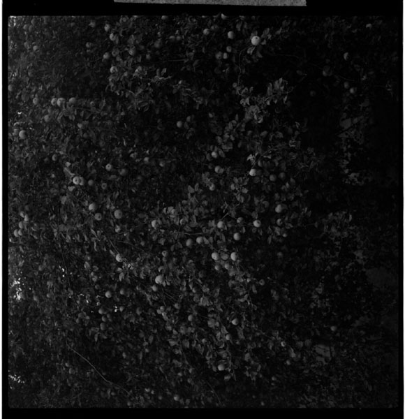

Here's Another 6x6 Cutfilm Scan.
Handheld Hasselblad 500C/M, 80mm F2.8 C T* Planar, Efke 100 6x6 cutfilm in Hasselblad Single Exposure Back. Processed in ADOX Borax MQ developer, scanned on Epson 4490.
This was a good year for apples, in our backyard.
