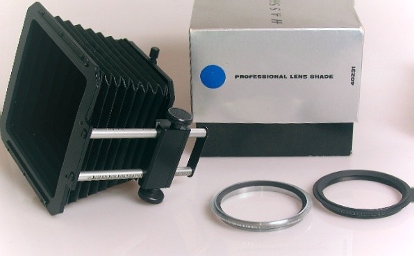

Early Proshades
Early covers more than one proshade.
I haved a hunch you mean the shade with non collapsible rails.
Shade 40231 with chrome and black adapters for Distagon 50 and 60 lenses.
The 40231 pros shade is suitable for lenses with B50, B60 and 63 mm threaded lens mounts.

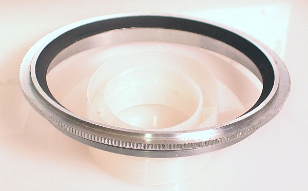

Close up of the chrome 63 mm adapter ring.
This ring looks much the same as the filter locking ring for these lenses.
It has a wider rim though that is used to secure the adapter to the proshade.

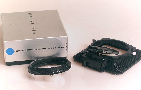

Second model proshade with 63 mm adapter.
This pro shade with collapsible rails is used for lenses with B50, B60, B70 size bayonet and
63 mm threaded lenses like the C series Distagons.
Adapters for the 40231 shade are not so difficult to find.
Prices vary from 15 to 25 USD.
The 63 mm adapter for the second proshade is much rarer.
A clean adapter will go for 30-40 USD.

Vic, The 40231 is the shade I want to get. Therefore, to put it on my old 50mm Distagon, I will need which adapter? Will it also work for a chrome old style 80mm Planar (Bay 50) and the old chrome 150 Sonar, which I will also need the same shade for?

Hasselblad made a mess of bayonets and threads for lenses that allow you to fit a regular or a pro shade.
Bayonet 50 is actually 57 mm and so on.
Inlay fliters for Distagon lenses are 63 mm the thread is 67 mm but not the one use with other manifacturers. Hasselblad lenses accept the other 67 mm thread but only for a couple of turns......
Planar and Sonnar lenses from the C series use B 50 to connect shades or the adapter ring from the proshade.
With the model 40231 proshade you will need both adapters B 50 and 63 mm threaded.
Black or chrome 63 mm ring is not important only cosmetic.
