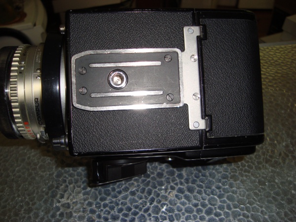

It would help if you show a pic of the bottom end of the 503CX you have.
The 500CM should accept the dual grip without any problem.
Here is the pic of the 503cx bottom. Another question, does anyone know of a dual handled grip that could be used for the modern cameras?

Any dual handled grip I've seen has a 3/8" attachment screw. The bottom of your 503CX tripod mount is 1/4". No go.
Terry
You can change the 1/4 thread in your camera for a 3/8 Thread.
Hasselblad supplies the 3/8 nut as a separate part.
With a suitable screwdriver you can fix this in a couple of minutes.
Vic.
I received the part yesterday from Hasselblad. Took about five minutes to take out the old 1/4" adapter and put in a 3/8" adapter. Total of 8 very small screws. Now the 503cx fits my old grip.
Total cost was $21 plus UPS shipping. Sure is a lot cheaper than having to buy a new grip, etc. Now I can use my CM and CX interchangeably.
