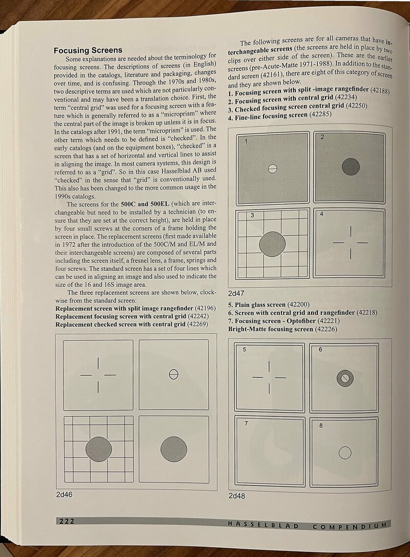

According to RICHARD NORDINS HB COMPENDIUM the screen seems to be the 42250 .
Please see the right column of the attached image . Position 3 .
I hope this helps .

Good day jotloob,
Thank you for your prompt reply. I really appreciate your feedback. I came across a link to the HB COMPENDIUM in my search, but did not go into such detail. I have reviewed your attached image, and using this information, I came across a focus screen that looks exactly like the one I currently have. I have attached a picture below. The description reads 42234.
View attachment 7486View attachment 7487

Sorry, I am not very experienced with my computer phone. What I meant to continue to say is, do you agree with the description of the attached pictures, that indeed this focus screen is 42234. In my research, I have come across incorrect product numbers for specific Hasselblad parts, especially on eBay.

Hello Kitt
The screen you showed when opening this thread , has grid lines and therefore is most likely 42250 .
The screen you show in your answer has NO grid lines and is NOT 42250 but 42234 .
Conclusion : The two screens are not the same .

Hi jotloob,
I see the difference in the two screens. Based on your information, I am confident that I have the 42234 screen. The grid lines that are on the original pictures I posted are pencil line I added myself to aid in composition.
I want to thank you for help.
