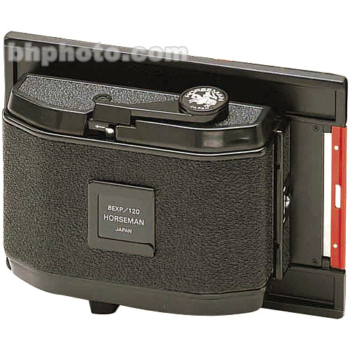

Since you also said "or whatever you suggest i use instead to be able to shoot 120 film as a back on the Sinar F2".....if you're not wedded to the idea of putting a Hasselblad film back on the F2, then check out the other roll film backs that are designed for use on a 4x5 view camera. I have a Horseman 6x12cm roll film holder designed to use on a 4x5 International Standard style back and it works very well on my Sinar P. Horseman roll film backs are pretty easy to come by, new or used, and are available in several sizes (6x7, 6x9 and 6x12).
However, the most convenient arrangement would be a sliding back adapter of some sort.

thanks for your help....talk to me about the model you depicted....i have seen these available.....how does it all work considering now i simply put in a film holder in front of the ground glass.....

Basically, you focus as usual on the ground glass, but instead of sliding your 4x5 film holder under the ground glass, you have to removed the International/Graflock back that holds the ground glass and replace it with this roll film holder....so it's a bit of a hassle, as I mentioned. Calumet and I think also Sinar made roll film holders that slid under the ground glass in the same way the standard 4x5 sheet film holder does.
I have never seen an adapter for using a Hasselblad film holder, the issue with trying to use a Hasselblad back would be winding the film in between shots. The old Horseman backs had a winder integrated with back, like the one in the picture above.
I had a back on my Sinar that would slide to the right to give me a ground glass that I would focus on, then slide to the left to bring the film back into position. That is the hot ticket with the Graphloc type backs ( like the Horseman ).
