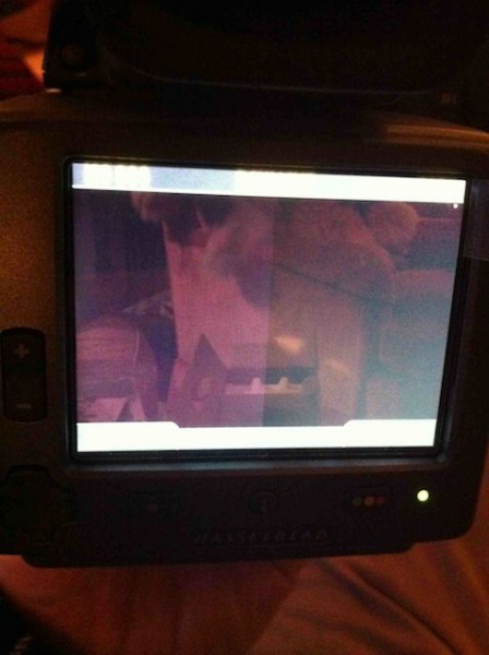

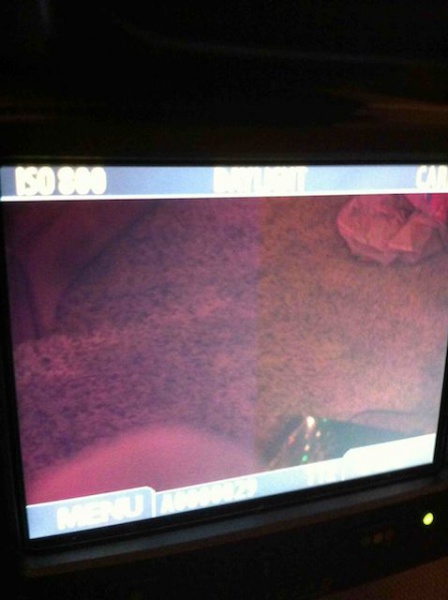

hi i just got a h4d-40. super stoked, but i have a question im hoping another h4d owner might be able to answer.
when i shoot any underexposed image the lcd preview screen comes up with a strange line right down the middle of the image. has anyone ever seen this? and what might it be?
heres a couple pics of it

I think every h4d-40 have this. When the picture is underexposed, then you can see the effect from the "double readout" of the sensor. lg, rem
It happens with H4D-50 too.
My assume is because underexposed, i hope Hasselblad find way to solve the problem.
