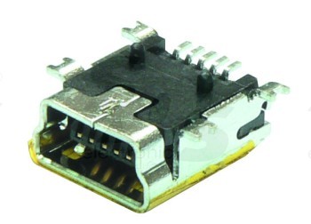

Well.... I did not want to say/write that before but to me this smells like a back that had a knock on the connected Firewire plug.
These connectors are typically surface mounted devices similar to this one
The picture shows it upside down, the tiny pins on the top connect to the printed circuit board. Mechanical stress like a knock on a cable can force the pins out of the solder. The metal casing you see is also soldered onto the circuit board. No screws or anything really robust.
Worst case situation would occur if the printed circuit traces got ripped from the printed circuit board. Standard repair approach would be to replace the complete circuit board. Read: $$$$ costly. With enough patience and manual dexterity one can often repair (resolder) things but that needs someone capable and willing to try that. I have done this kind of thing myself but it is tricky and there is no guarantee one can fix it.
Not good news I'm afraid...
