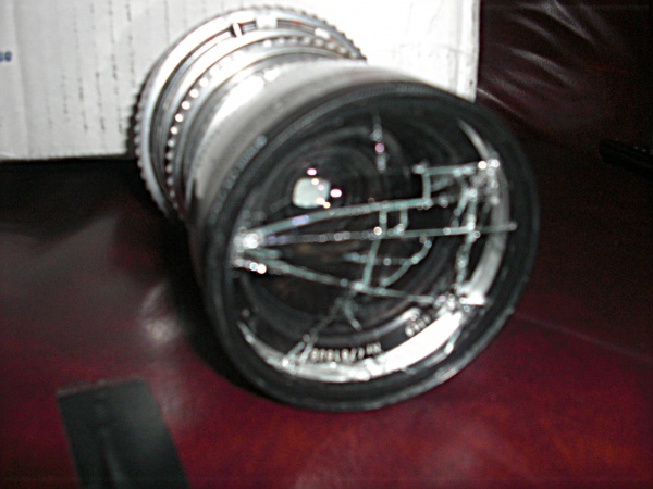

My 50 Distagon was probably damaged in the mail last week when it arrived. The Ebay seller put it in a shoe box, wrapped it in newspaper and charged me $49.50 for the USPS delivery.The front UV filter on the lens was smashed. He had taken the lens cap off and wrapped it separately. I think the lens took a blow to the front element. I will see how the photos I took yesterday look in a day or so.

I would not spend too much time on the 50 Distagon.
The seller does not stand a chance to claim the damage with USPS.
Inform him the lens arrived damaged due to insufficient packing.
What good are lens caps if they are not used for lenses in transport?
This must be a confused person.
eBay purchases paid for by PayPal are fully covered.

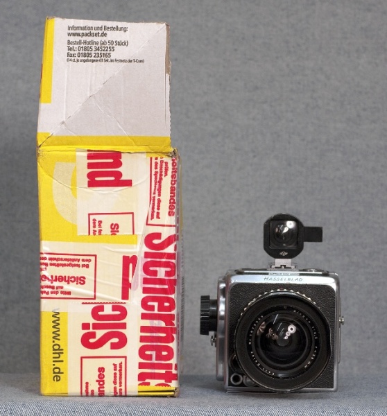

Could be related to the fool who managed to push this camera in a small box.
Shoebox is too much credit for this box.
Rare SWA camera destroyed in transport.
Seller is a professional trader of camera gear!

Thanks Vic. Here is a photo of the lens when it arrived.
