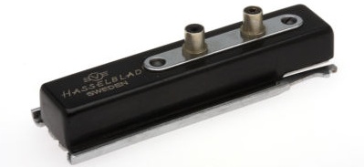

Thanks for the speedy response and flash sync speed info. With regards to the connection between the camera and the flash system - The contact posts look alien to me as I only have experience with the modern hotshoe type. Is there a specitic connector or adaptor that I need to get hold of to connect the vintage equipment with modern gear?
Apart from the adapter you posted the URL for there also exists a version that will fit "normal" sync cords.
The adapter with PC style contacts and a simple wireless system offers the safest and easiest operation for a studio flash.
These wireless systems are offered at several auction sites for around 30 euro.
The adapter is rather rare and needs more time and good luck to find.
There is one on evilBay, that is where I got the picture from. ISTR around 45 EURO
Thanks again for the advice, guys. After a quick look on ebay and looking more closely at the pictures, this looks like it has the right contacts, although please feel free to correct me if I'm wrong:
Yep, that is the sportsfinder/sync-contact combo solution.
