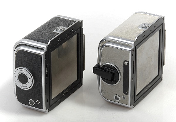

Unless there is a problem with the crank mechanism you can turn the handle anti clockwise to lock it in the right position.

Turning the crank anti clockwise only goes for automatic magazines called A12/A16/A24.
If you turn the key on older 12/16/24 magazines you reset the frame counter.
Not a disaster untill you notice you have lost a number of exposures........

Left older pre automatic magazine, right in grey an A12 model.
