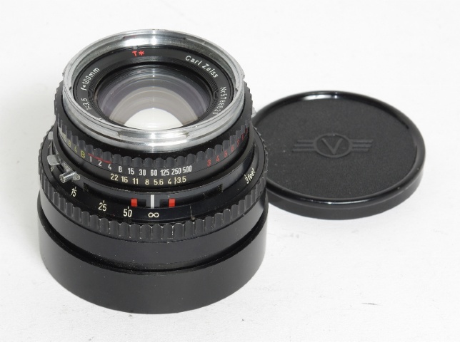

Two rare samples of the 100 mm Planar.
Left the C version with T* and chrome front ring, right 100 mm Planar in MK guise.

The oldest 100 mm Planar lens I have was made in 1968.
Total production of C model 100 mm Planars was just over 10.000 units.
My estimate is total production of all 100 mm Planar lenses, C, CF and CFi is less than 25.000
That makes the 100 mm a rare lens compared to the 80 mm Planar of which around 400.000 lenses
were produced in C, CF, CFE and CFi guise.
