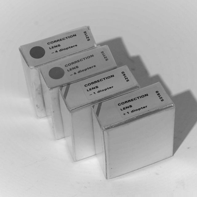

Correction lenses for eyepiece
Hasselblad used to supply a full range of correction lenses for early prisms.
I have a selection of correction lenses available for early prisms like the NC2, VFC 6, PM(E), PM(E) 3 etc.
Dioptres go from -4 to +3
Most values available, new boxed with fitting instructions.
Check the prescription of your glasses or have the glasses measured to find out what dioptre you need.
Fitting is quite easy.
Send me a pm for more information.
New old stock

Nearsighted means a -diopter.
Just checked my correction lenses.
I have -1 and -4 available.
