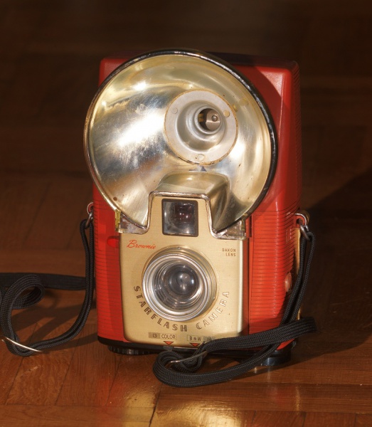

Here a picture of an old Kodak camera taken with a 1000F 250mm/5.6 and CFV-39
