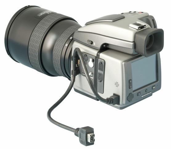

HB tether lock
Hi gents
I've solved my problems using a combination of a shorter firewire cable (1m) and the following HB tether lock - this does make for a more stable connection.
Thanks for the advice and input.
Best, S:)

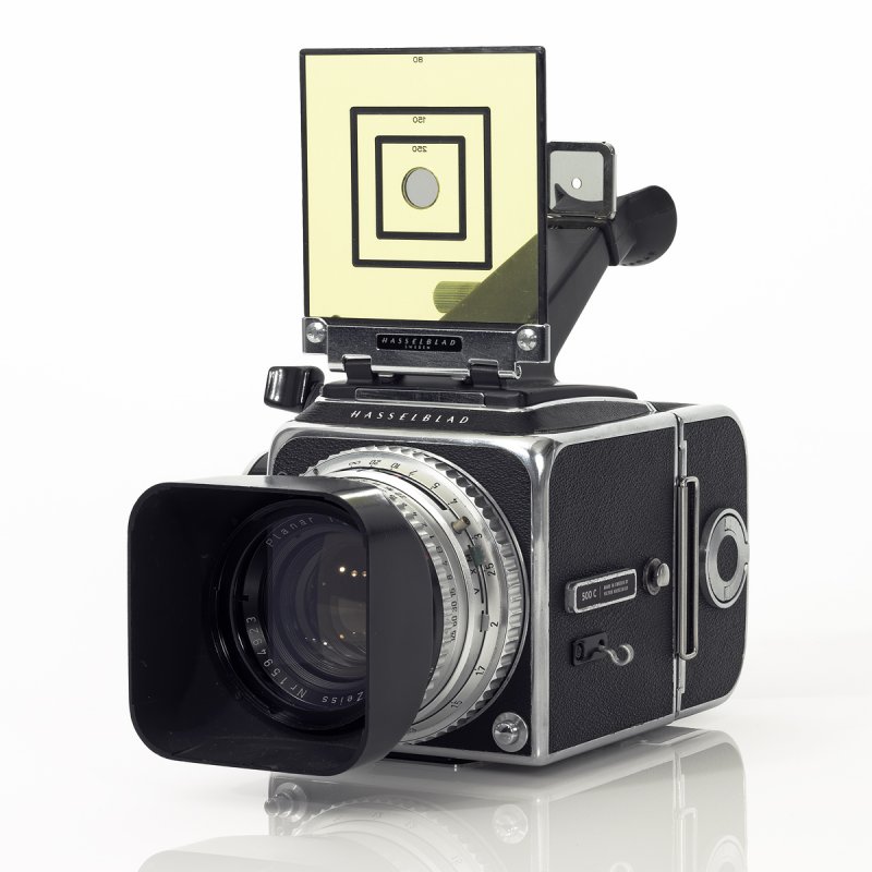

Cable hook
Hello Sinhue
HASSELBLAD solutions like the one you show in your image date back to
1957 .
Have a look to my image an see the little hook on the left side of the
camera . Its called cable hook and has the partnumber 43036 .
Possibly the smallest HASSELBLAD accessory part at all . BTW , very rare .
It was used to hold the flash sync cable .:daumenhoch_smilie:
HASSELBLAD 500C from 1960 .
Have fun and enjoy your camera .
Best . Jürgen
