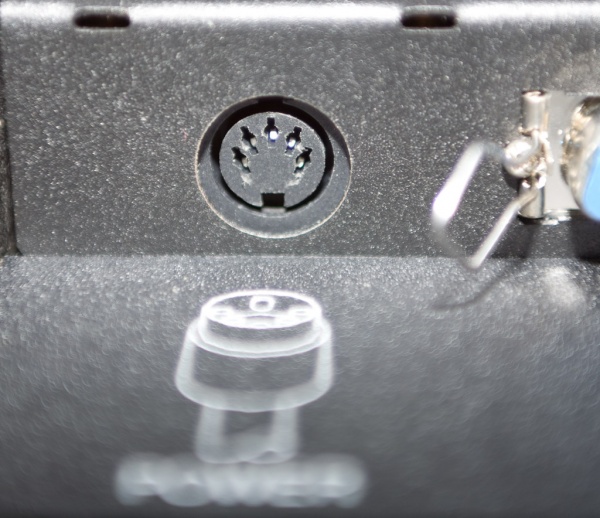

Here's a photo of the contact! I'd really appreciate if you could find something that would fit !
Thank you!

The plug you need is a standard DIN one often used in home audio systems.
You also need a power supply giving + and - 15 volts and + 5,2 volt.
