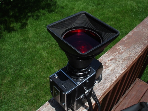

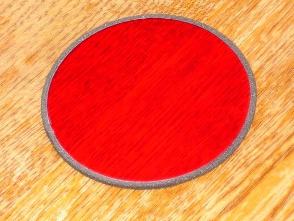

Here is my Final Solution - Sinar 103mm to 40CT*
After many tries, here is my final solution to putting Sinar 103mm Glass Filters onto the Hasselblad 40CT* Glassless Filter Mount.
Applied adhesive-backed foam (made for camera light-trapping) of the appropriate thickness, cut with my rotary trimmer. Applied the sticky backed foam all around the Sinar Filter, and it fits very tightly, so I am pleased with the end result, shown here:

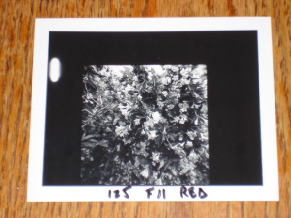

Here's an Instant Proof shot with the Red Sinar Filter
Fuji 3000EI Speedy, Very Overcast Day. Minimum Focus Distance, 500C/M with #52051 Meter Prism Finder moved forward until in proper focus. Sinar Dark Red Filter. See No Vignetting! The dark red filter lightens the dark red flower petals, of the "burning bush" in my front yard. The NPC Polaroid Back produces a "light leak" from the release button on the front. I will soon be covering the inside of the back with black wide vinyl tape, that should seal the leak.
I'm also using a 4X Neutral Density in Sinar 103mm with the 40mm F4 C Distagon. Great Lens!
