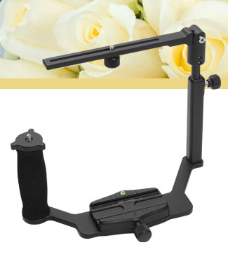

I am using pocket wizard triggers with my Canon 1D to control both my Canon flash units and I have a Profoto 600w portable unit but with only one head. So the idea of using something similar with the H4D seems self evident. I guess I am just trying to get a sense of how much of my existing lighting gear is going to be able to be used with the H4D and what other equipment I might need.
I already expect that I may need a Metz flash to use as an on camera flash if the Metz 76 will give me more puch than is available with my existing Canon 580ex2's (the Metz 76 Mz5 - claims 12 f stops so I assume that will be more than the 580 would give me).
Are these the sort of Kirk brackets you are using with your H4D?
Thanks again for your help.
mal
