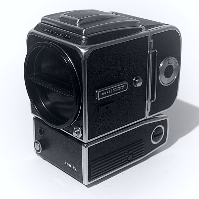

Choice?
Would this be a good choice here?
500elm-- No lens though. Has some sort of 'thing'y' on the bottom? Film winder?

This probably what you have seen.
This EL is the model before the ELM you mentioned but they look similar.
The unit under the camera body is a motordrive that transports the film and cocks the shutter immediately after an exposure has been made.
This camera is not the one I would recommend as a starter kit because it is best used on a tripod.
Bodies without a winder are suitable to be used both handheld and on a tripod.

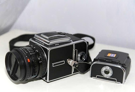

Depending on your budget a later model without motor part is probably a better choice.
Buying a complete kit, body+lens+film back, may save you some money.
Later 501CM camera with 80 mm CFE lens and film back.
An extra film back on the right allows to reload fast or use two different types of film.
