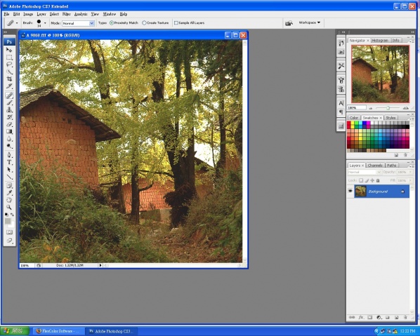

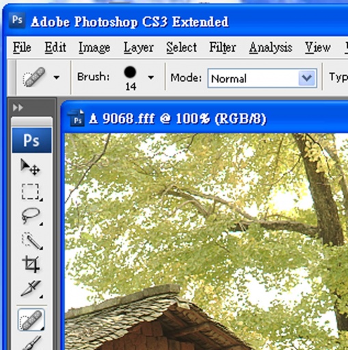

There is a plug-in by Hasselblad to read .fff file format (not .3rf file) which can be downloaded from the following link:
http://hasselblad.com/service--support/technical-support/flexcolor-software.aspx
Although it is claimed that for scanned file only, but I can open and process images after loading .3rf files in flexicolor which then converted to .fff files automatically. Attached is an image of the PS CS3 screen after loading the .fff file.
