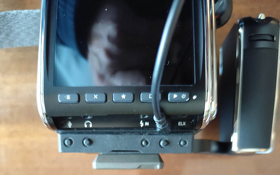

the digital back has a flash out 2.5mm opening. I am guessing that's what you are talking about can you check for continuity on your cables? i.e. that the signal gets transmitted?
Thanks for your reply.
I do indeed connect the cable to the flash output and the other end (PC) to the sync cable. And the sync cable works because I've tested it with other cameras. I've also used other connections and other flashes, and it still doesn't work.
I suggest you test it with another flash to narrow it down, i.e. b/w the back and a flash directly?
Well, it was the flash output sync cable that comes in the box with the 907x and the CFV 50. That is, it came defective from the factory. I ordered a new one from Hasselblad, and all the flashes work correctly.
