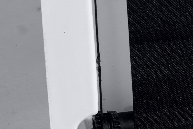

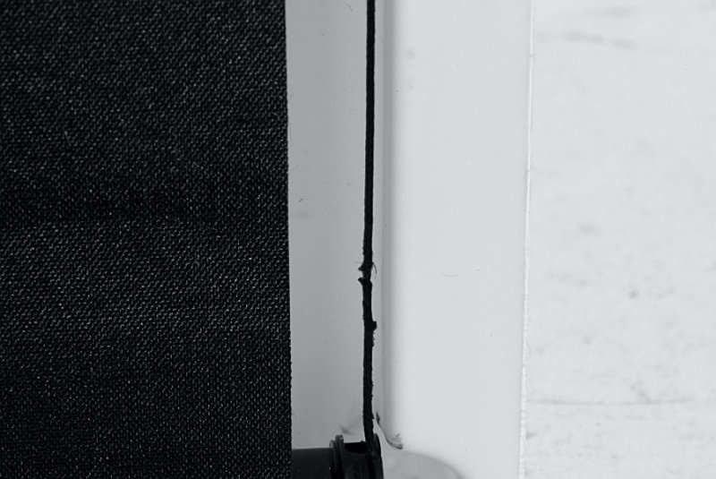

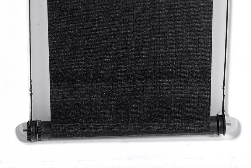

2XX series cameras have a focal plane shutter that is made from a light weight textile.
These shutters are very strong and can stand a certain amount of abuse.
The shutter or the cords that pull the curtains can be seriously damaged if the shutter is tripped with an attached
film back whose film is not completely wound on the take up spool.
If the camera is cocked under these circumstances cords may break or the curtains will be damaged beyond repair.
205 shutter cords
left cord
right cord
Damage to cords due to mechanical overload.

Do not worry, this 205 camera is back in excellent condition a replacement shutter was fitted.
