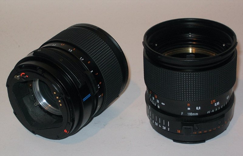

Hey Paul, In your garage do you have any parts to convert a 110mm F to FE ??????????

What have you been up to? Buying old F lenses and keeping me busy to convert them to FE spec? I suppose you are looking for these?
They were lying behind a Maserati gearbox and a couple of blown headgaskets.
I am not very good at throwing things away that I paid good money for.

Hey Paul, Those lens barrels look like they are ready to put my glass into.
I must look in your garage if I ever get to Germany!
Terry
Hello Terry,
Better hurry because there is already an interested buyer for one of these empty jars.
One of these beauties is for sale.
It is easy to persuade me with a decent offer....
