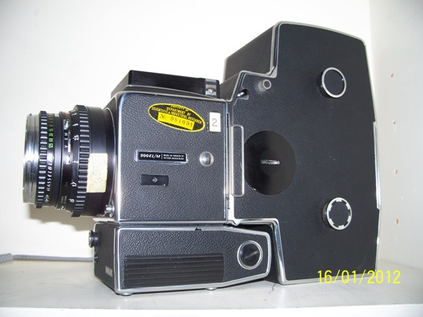

250 Exposure back.
No this is a completely different than the 70 magazine ,its about 8 inches long and has two cassetts inside ,havent opened yet as has a film inside .The shape is moulded to fit over the motor drive .Complete outfit come with 9 x70 magazines and 4x EL 500 camera bodies ,these all have special viewfinder plates ( removable ) that set exposure etc .This outfit was used by Aerial Mapping company around 1980s . . Ogrove
Yes it is the same as the 70 /500 in the photo ,will attempt to post photo . ogrove

Sounds like the Magazine 70/500.
As the name says 70mm film for 500 exposures!
Is driven by separate battery, not from the EL-body.
http://www.hasselbladhistorical.eu/PDF/HasManuals/70-500.pdf
http://www.clubhasselblad.com/hasselblad-70-500-film-magazine-0

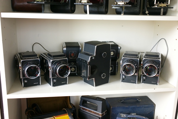

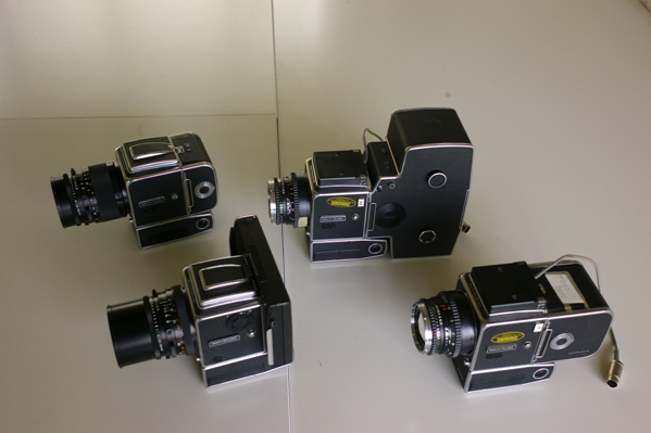

Hasslblad Backs.
Hi Here are a couple of photos of some of the other backs for the bodies I have in my collection .The number of the 70 /500 magazine is nu 1034 and it has Made in Switzeland below the number . ogrove

That Magazine 500 is sooo sweet. I would love to find one of those. I have six working A70 magazines, each presently loaded with usuable film.
