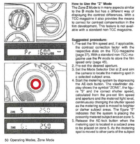

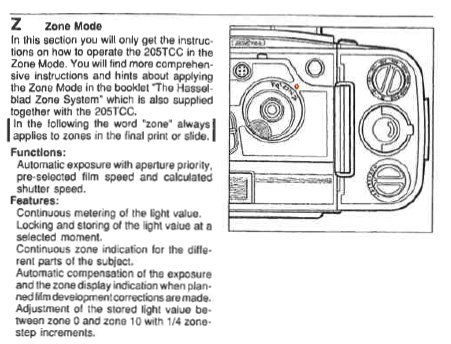

Hi there...the 205 TCC body has in-camera light meter of 3 degrees and a zone system metering function I believe....can anyone enlighten me on how it all works and whether worth getting.....can these bodies be used to meter C lenses with the lens shutter 'disconnected' to use the body shutter.....I have a 50mm C lens that's misfiring at 1 sec. 2 secs.....

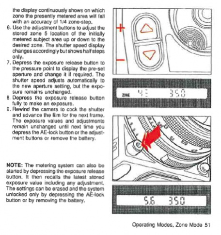

For zone mode operation see the following:
