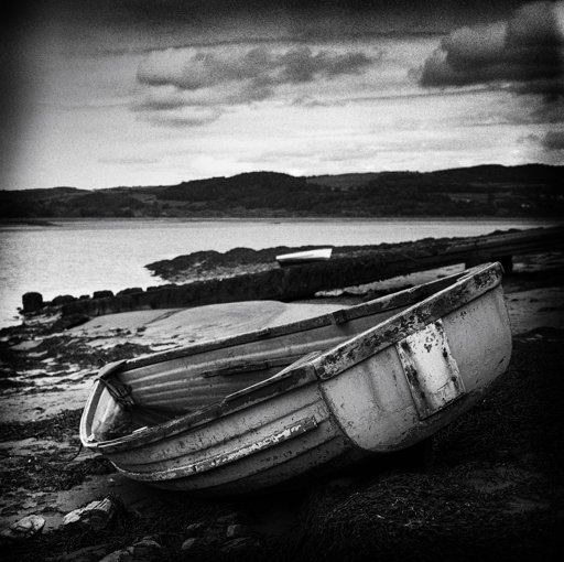

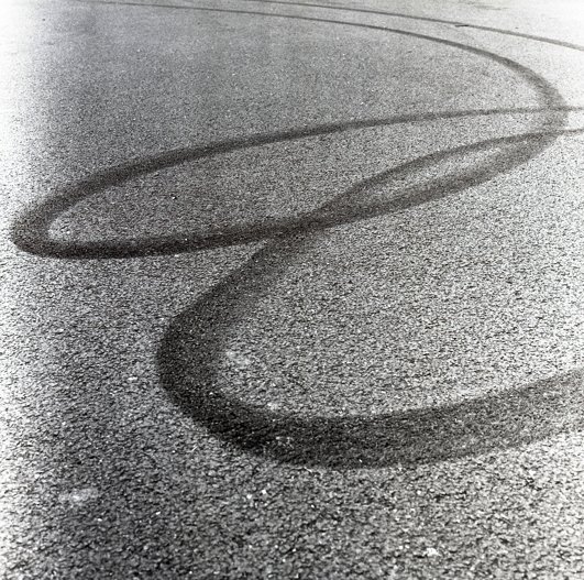

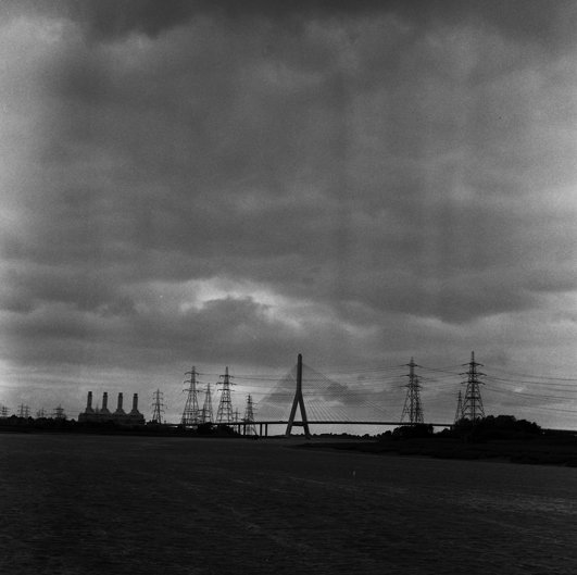

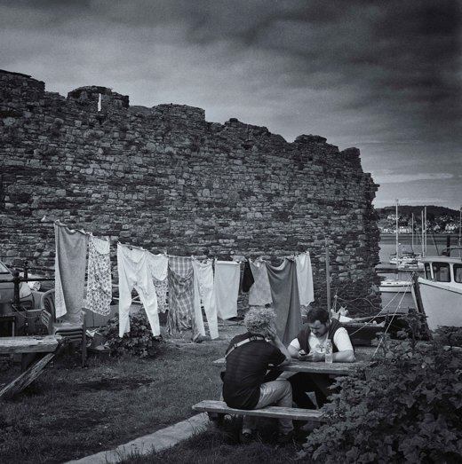

Can i add something to this, here are 4 negs some have lines and defects some don't , but on this 3rd and 4th test shot i have deliberately turned the brightness down and the contrast up to show you, these are not scanner lines, are they ghost ladders caused by over agitation? or is it something else on the camera back Hasselblad 500 ELX 80mm lens, fuji neopan 400 iso film for all images. i have never ever encountered this before, its all rather puzzling! image 1 has vignetting by design not a defect of camera etc.

Well, looking at image n° 3, it looks like light flare. As it occurs at the left side, it might NOT come true the leaking light seal of the Hasselblad film holder because, as the image is projected upside down, the flare schold be on the right side of the print. The light seal sits in the slot where the protection slider is put, and is the most vulnerable part of the entire Hasselblad system, but you know that ofcourse.
On the other hand, the strikes all over the image, as in the fourth picture, according to my old AGFA-Gevaert handbook, it is caused by something during the developing process, mainly short times or bad agitation. But, as you explained, your processing seems to be good.
