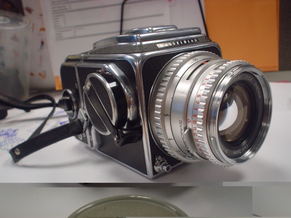

I know you all know what model I'm talking about, but I took a quick shot of it at work.

You will be surprised to find out how little Hasselblad cameras have changed in appearance.
If the lens was bought together with the camera body you have a 500 C camera in your hands from about 1966-1967.
On the left hand side you will find a little sign stating Hasselblad made in Sweden.
That is where it reads 500C or 500CM.

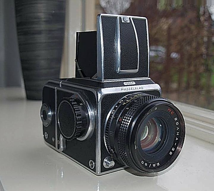

I am impatiently waiting for a SWA and a 1000F . (Not 1000FK! ! ! :D)

I am not sure the conversion from 1000FK to 1000F has been carried out if at all possible.
You will just have to wait and see!
Rare 1956 1000F kamera converted to K mount.
You will come to like this camera Jürgen.
Think of all the great Arsat lenses that are now ready to go!

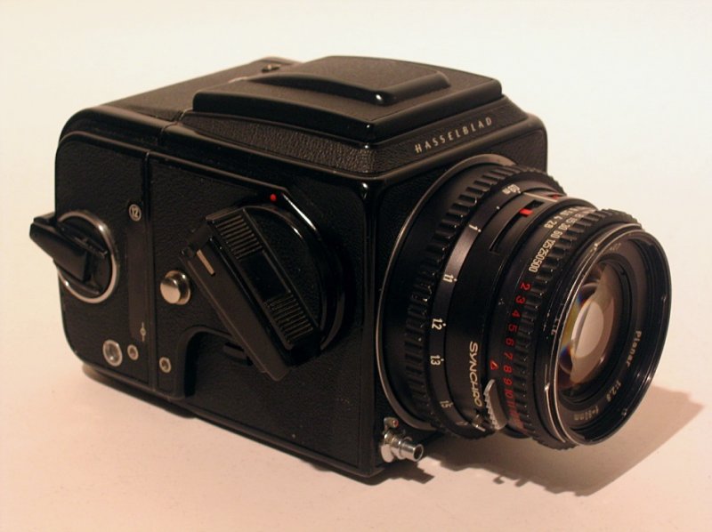

A 1982 black 500CM with C series lens.
Not all that different from Charlies camera.

I am still in favor of chrome plated camera finish. No doubt about it.
After selling your excellent black 500 CM to a young lady I thought it was a good idea to show my black 500 CM with T* lens and later A12 film back.
It is a nice contrast with Jürgens 1000F(K) camera and shows how little the basic design has changed in all those years.
Charlies 500C is somewhere half way and has a strong resemblance to the 1000F camera.

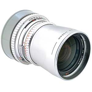

Charlie that is a beautiful 50 mm lens and a rare one too.
Your lens has the later T* coating. That is quite rare for a lens from the first series with silver finish.
T* coating is found on almost all later C series lenses with black finish like the one on my black camera.
No definite production numbers are available but less than 1000 of these silver 50 mm lenses with T* were made by Carl Zeiss in Germany.
Your 80 mm Planar lens has the early coating.
This 50 mm lens has multi coating that is less prone to flare and gives improved colours as well.
The 50 mm is a wide angle lens comparable to what a 35 mm lens is in 35 mm photography.
Wide angle means more of the scene gets in the frame and perspective is changed as well.
For many Hasselblad users the 50 mm is their most used lens.
Fit the lens to the body and look what a wider angle means for the image.
Just use the lens and see what it does for images.
I think you will like the results.
