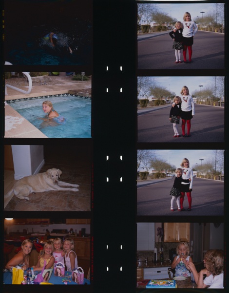

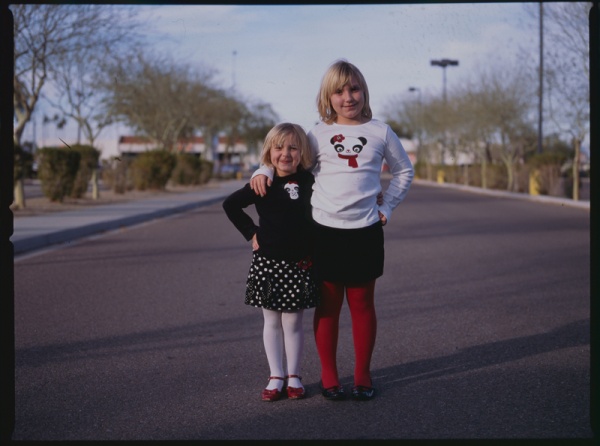

The included instructions are on disc only and include just the lame help search you speak of, but the software is pretty easy to pick up. I just got a new V750 this week and have been experimenting and getting decent results with the included holder (surprisingly good results). The film does not lay perfectly flat but the overall quality does not seem to be affected greatly. I can get 3 6X6 shots per row or four 645's.
Some examples:
