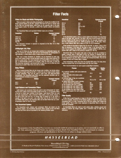

I think Hasselblad and Heliopan designation are different. I am uploading a page from a Hasselblad dealer price list with their filter specs.
Terry

Thanks Terry,
This is exactly the answer I wanted. For me a 81A as CR1.5 as seen in your attachment is not skylight in my world but warmer.
So Paul you were right that hese two filters are not directly comparable.
Since color properties are very important for people who wants the best color fidelity from their glass - so is the knowledge of what the filters produce. I find that discussions about filter properties are getting less and less in the digital world. Even there a proper use of filters gives a larger dynamic range of colors or color gradation. Reason - its the raw picture from the sensor thats the basis of the dynamic range - larger change in white balance after the picture has been taken can never give as good a result as when the smallest possible correction is necessary. A fundamental thats learned by students studying digital data processing. Therefore using filters in the way people did in the film time is still a good advice if one strives for "best possible quality" in the picture.
