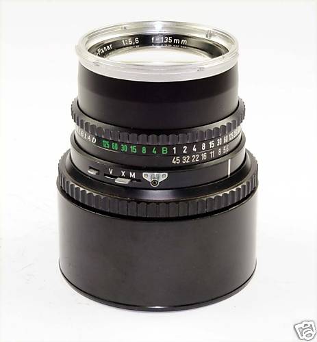

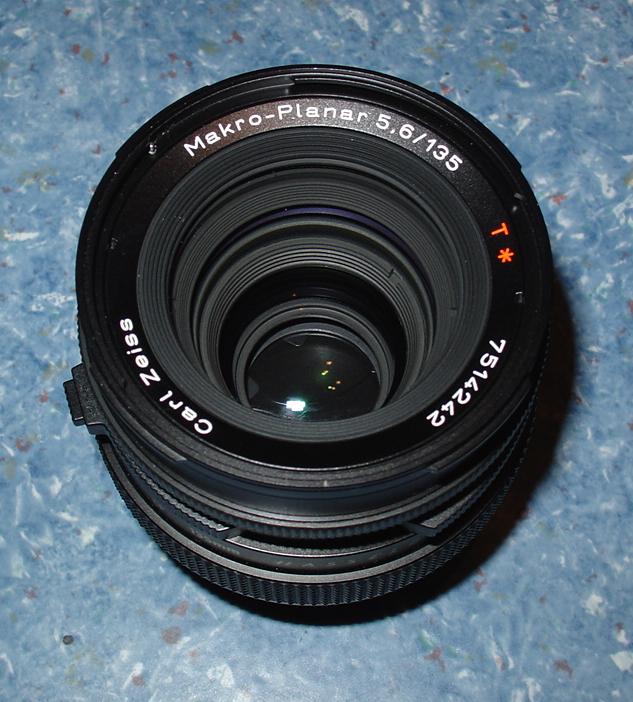

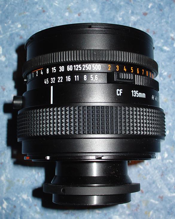

135 mm Makro-Planar from the CF series
135 mm S-Planar from the C series
With the change to CF series the optical formula for both the 120 and the 135 lenses changed.
